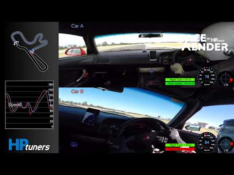

                          HKS GT S/C vs N/A PB laps analysis.
                          As I was curious to see the quantifiable difference between the speed difference between the N/A PB (1.33) and SC PB (1.32), I over layed the lap data and both videos and combined it into one using Racerender + Racechrono.
                          This way I know exactly where I can improve on and where the S/C excels at. And clearly the S/C has a huge acceleration advantage.
                          Areas to improve on in terms of driving.
                          - Drive smoothly, oversteer is cool and exciting but it is slow.
                          - Clearly down significantly in cornering speed everywhere, especially at the sweeper where I am not confident in taking 4th as hard as I was compared to my previous N/A setup.
                          - Experiment with 3rd gear at the double right handers leading onto the main straight, with access to more midrange torque/power the car should carry enough momentum to still make this gear usable.
                          - Get on the power early, the power isn't that scary anymore. The car + tyres have the capacity to handle it.
                          - Modulate the new big brakes better to not overbrake the car into corners, compromising speed.
                          Areas worth looking into in terms of car setup.
                          - Engine is currently limited to 8800RPM. By increasing the limiter back to 9000RPM, I can potentially save a shift into 5th before entering the S, therefore only requiring one downshift from 4th to 3rd through the S BEND.
                          - Seems to be more understeer? Perhaps due to the added front weight of the S/C kit + slightly worn front tyres. Maybe look into a softer front sway or decrease damper stiffness.
