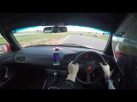

The current Phillip island PB is a 1:48.2466.

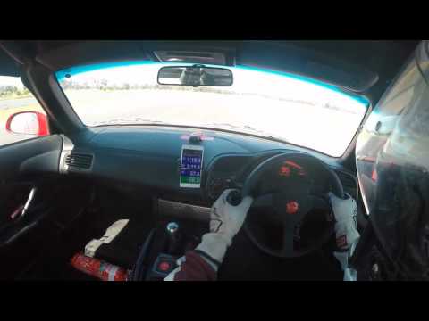

The day was well run with plenty of track time. However this new setup was tricky to control to say the least. This is due to the OEM front FSB which pretty much increases front end grip and the LSD wanting to rotate the rear when power is applied as it locks more aggressively. The LSD is great as I can really feel what the rear end is doing which makes catching the oversteer more fun and easier.
On throttle the car wanted to rotate and at high speed the cars rear end would snap away at times, it took a lot of work to control it but it was plenty of fun.
I had adjusted the angle of attack of the Voltex rear wing for more down force which helped stabilise the car at high speeds however it created more drag which affected acceleration and top speed which the video will show.
The fastest lap time of the day was a 1:50.2643 - far off the current PB of 1:48.2466.
Looking closely in this video, at the end of the lap before entering the main straight I was up by -0.5 in sector time, however as I was entering it showed +0.4 in sector time and gradually kept increasing. I believe this is due to the increased drag of increasing the angle of attack of the wing slowing the car down. The car doesn't have much power so the changes of the rear wing angle is pronounced.

Current PB
Today's data

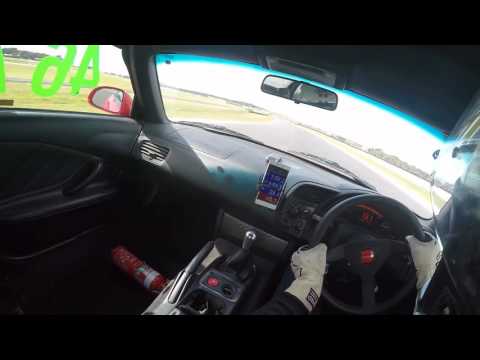

S2000 and S14 chilling
