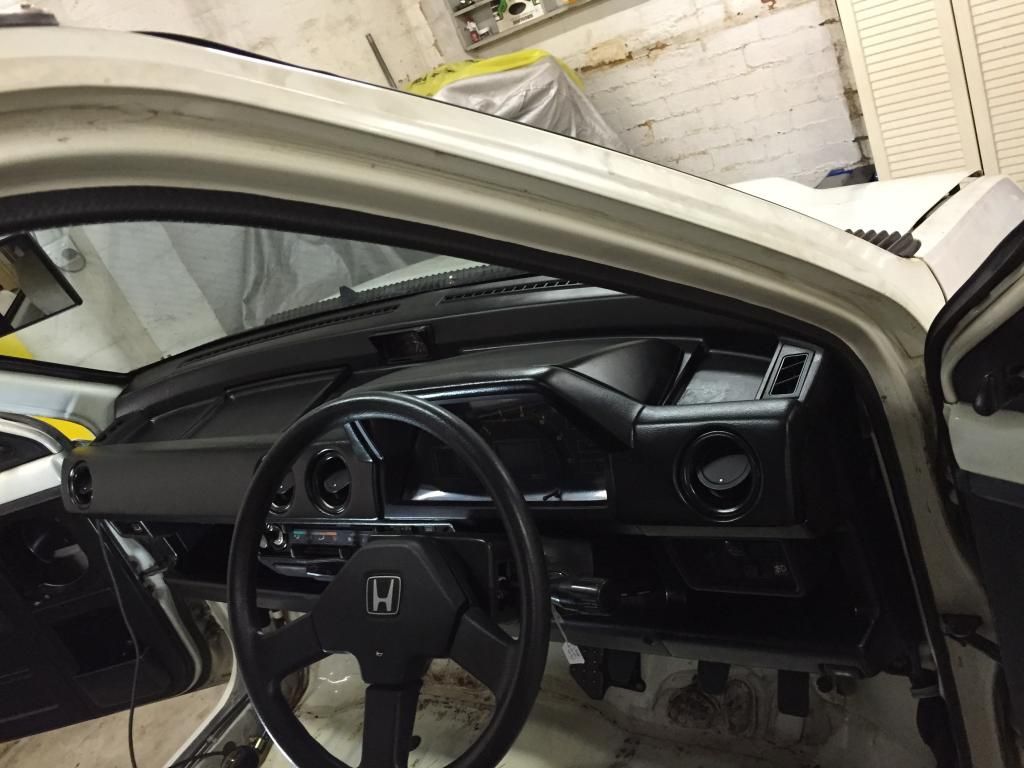

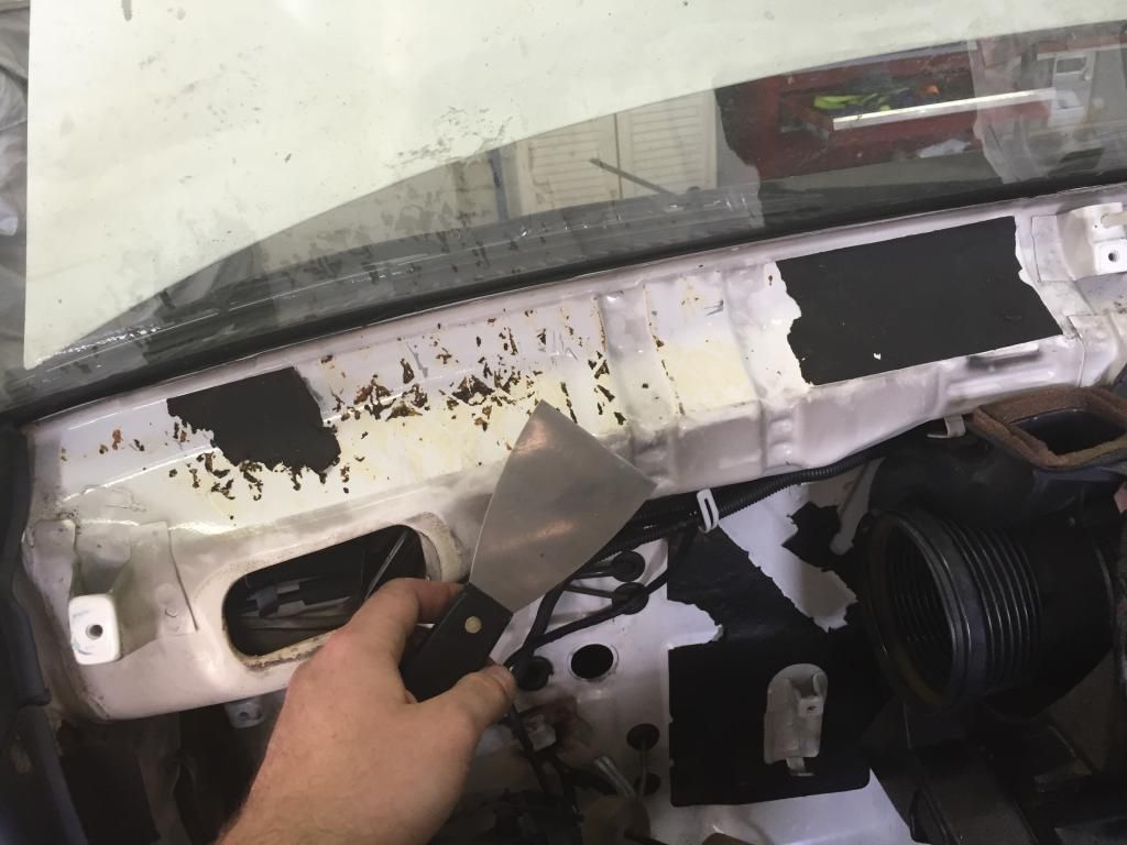

Getting rid of the sound deadening so we can refit the dashboard.
It's not pretty, but it will all be hidden anyway.
Cleaned up dash and the A/C evaporator box fitted with all its insides gutted. It needs to be there for the normal fan blower to get air from outside. Should work well like this.
Next step was preparing the dashboard to go black. One of the wrecks we stripped parts from has contributed a bunch of factory black dash bits, but the stuff individual to this Japanese model is getting vinyl dyed.
Looks pretty damn good! I did this in another car years ago and was happy with it. Can't wait to see it installed.
We ran out of time to fit the dash after dying it today, but later this week we should have an update.
