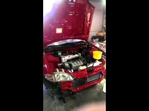

      Finishing touches *hopefully it fires up lol*
      $2.95 30cm strips of adhesive velcro are a wonderful thing
        #48
        Started it up today, cranks good
        Got a set of em1 wheels to keep it oem
        Set up a map to get it running

              Done! Just a bleed of the brakes and the clutch and first test drive is around the corner
              I'm using a CRV 1" BMC, as you can see the rear hardline on the eg is 10mm, but the fitting on the BMC is 12mm. $4 later, I have an adapter fitting. All that was required was a little massaging of the hardline. I want tot make some new hardline in the future that clear the CMC in a nicer fashion. but for now, this will work
