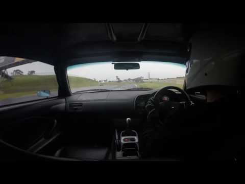

                      Nice save early in that video Todd! These S2000's are way too sketchy in the wet!
                        I'm not sure if it was the S2k or the RS3 but either way this track day was sketchy as! Not keen on trying it again haha
