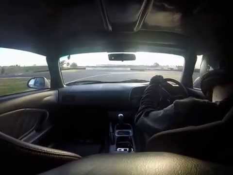

                        Session Three
                        I had dropped the PSI for this session to 33 HOT all round (was previously at 34 HOT). This helped the car through the corners and it started to feel a bit better. Car still definitely had some oversteer issues and at one stage I even lost it through turn 7 (honestly thought I was going into the wall haha).
                        Video below
                        https://www.youtube.com/watch?v=Rl8WeY3gp0I
                        Still managed a 1.54 this session so I went back in early to adjust for next session. Dropped tyre PSI again and decided to change the angle of my wing. With the new wing stands I had put the wing at the flattest setting as my base point. I decided to raise the rear edge providing a more aggressive AoA. In this process I discovered that both my lower rear bolts on the stands were loose allowing the wing stands to shift up and down (I mustn’t have tightened them properly when installing?) I gathered this had to be the reason for the erratic rear of the car at different times as the wing would be moving and changing constantly.

                        Session Five
                        Finally! The car I remembered driving was back. Turns were better and the car felt good. It showed with my times falling into the 1.53s. You can see my best lap from this session in the video below.
                        PSI drop worked well for a few laps but the PSI and temps stopped climbing and the front ended up being lower than the rear, which lead to the car understeering a little. You can see this in the video with me fighting/turning the wheel a lot more than usual.
                        After a few good laps and a new PB I came back in and adjusted the front PSI and waited for my last session.
