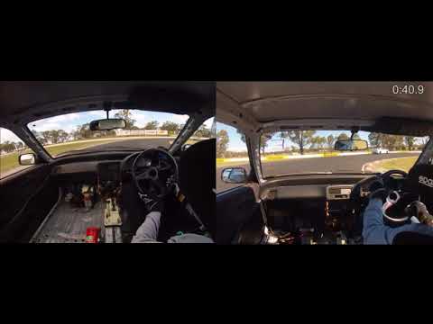

Made a bit of a comparison video to show the progress I've made/bought.
