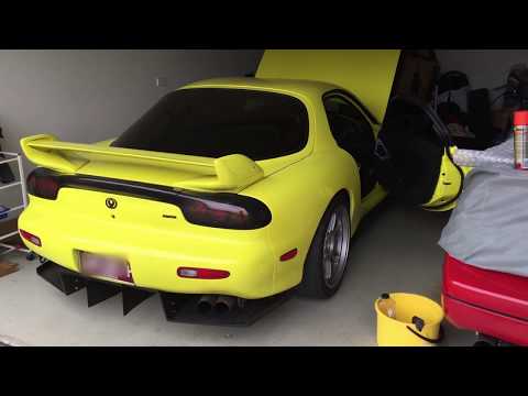

Sooooo, diverted some attention to the RX7 recently and added the below:
Full Function Engineering primary and secondary rails, dual in dual out setup
Turbosmart FPR1200 v3
Bosch EV14K 1000cc primary injectors and 2200cc secondary injectors.
Walbro 400 fuel pump
Blitz Dual SBC
Turbosmart 50mm progate
T04R bridgeport tuned on a power FC, clutch limited at 300rwkw on 16psi. Will probably need a Exedy Hyper Single or go twin plate. Engine is good for 20psi so something to aim for next clutch change.
Seems to idle fine on big injectors:
