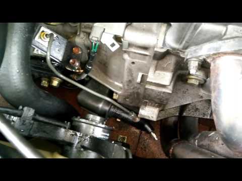

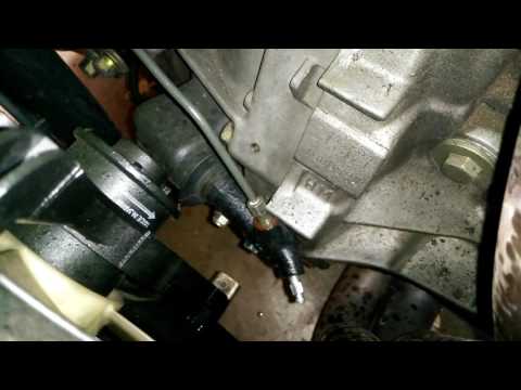

                            Not a happy day for Kenny's DC2R
                            Today we woke up to a DC2R with zero clutch pedal pressure.
                            Problems identified:
                            • Clutch slave cylinder flex
                            • Leaking clutch hard line
                            • Clutch slave cylinder bolts not tightening
                            I have a hunch that the leaking hardline would be a result of the flexing slave cylinder.
                            The 2 bolts on the slave cylinder seemed loose, so I made an attempt to tighten them but they wouldn't tighten even with finger pressure.
                            This indicates to me that either the bolts are too small or the thread in side the hole is ruined. Just to eliminate one of those options, does anyone know the spec of the OEM bolt?
                            So now we have a car out of action... And it is my brother's daily. What's the best thing to do to get this up and running ASAP?
                              From memory.... the bolt size is 12mm, thread pitch M8 - 1.25. Not sure if these are high tensile bolts, best to probably get it from honda for exact fit.
                              Fluid squirting out of the bolt head on the hard line. Check if the hard line bolt is actually tighten properly into the clutch slave cylinder. Make sure to use a flared nut spanner to save you dramas from rounding the nut.
                              For easier access to the slave cylinder bolts, remove the radiator fan from the radiator

                                Removed radiator fan to take off the slave cylinder.
                                The bolts that were already there were M8x1.25. The beginning of the thread in the hole was ruined.
                                Purchased a tap and die set and longer M8x1.25 bolts from Bunnings.
                                Extended the thread down the hole.
                                Use the longer bolts to secure the slave so it doesn't flex anymore.
                                Reattach the clutch line. (I didn't require a flared nut spanner)
                                Bleed the slave cylinder.
                                And we're good for now. We will order a new clutch line just in case. Go OEM or braided stainless steel?
