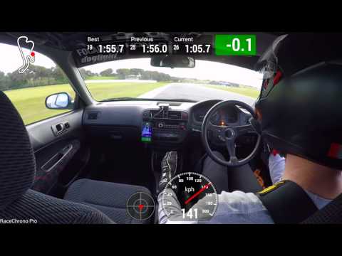

                              And here is my 1:55.43 lap for reference. It is quite over exposed. The GoPro didn't seem to handle the overcast/sunny/dark skies we encountered today.
                              So what did I learn?
                              The A050 is a really nice tyre, and I gained both from the extra grip, better feel and also the extra height of the front tyres.
                              I can still go faster through T1. I was actually turning in a few k's slower than when I was at VTA, so I think once I've done another couple laps on the tyre and in slightly warmer conditions, I can break into a high 1:54. I also believe I can get over Lukey without lifting, which would contribute to the lower lap time.
                              My new Spoon radiator cap didn't leak coolant, so that purchase was a worth it both for sick boi Honda points and functionality. I'm still ending up with more coolant in the overflow than I'd like, though it now retracts into the radiator once cooled. So the car is either getting too hot and/or there is something wrong with it. It definitely takes a beating on the track, and even more so with how much faster I'm going now that say 2 years ago when I did my first 1:59 at PI.
