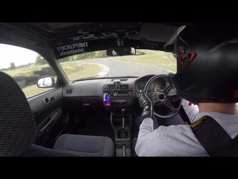

            Here is my fastest lap of the day/ever.

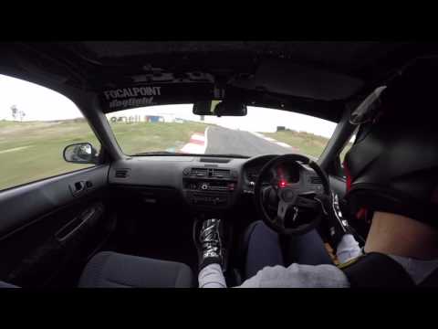

                    I mentioned previously I wasn't sure on my times for the figure 8, but now we've got them available.
                    I really am not too familiar with the figure 8 layout. I don't even think I've done it in this car, and maybe once in the XR5 previously.
                    From watching the video below, I can go quicker into the crossover both ways, I'm fairly happy with my exit speed though. The blind left hander after the first crossover is really difficult as it is blind (duh), I think I'll have to work out braking via a landmark/blade of grass on the side of the track.
                    I'm 3 seconds off the class lap record with this run, but I think I can make up a fair bit of time. My confidence is less than half it is on the clockwise layout.

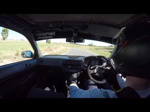

                            The 58.22 lap can be found below.
