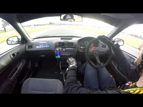

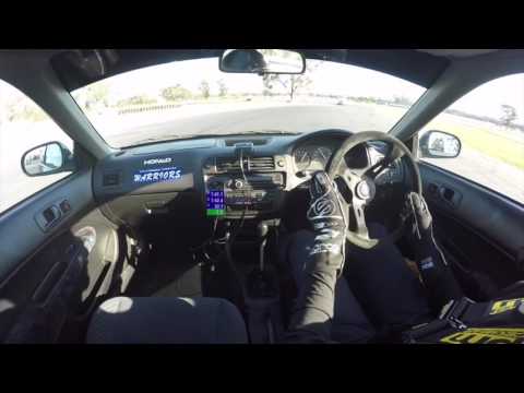

                      As you can see in the video below of my 1:40.0640, my notoriously inaccurate Racechrono decided to drop a .6 right before the start/finish to trick me into thinking that maybe I did a 1:39. I had questions in my mind and kinda knew it wasn't going to be that lap, or not as low as it was into the 1:39s.
                      One massive improvement I was making on Sunday compared to Saturday is i was using more of the track. Out to the ripples, running wide after the dog leg and even going flat through the esses to then head out towards the outer ripple strip. I felt really comfortable with what are notoriously large ripple strips.
                      Here is my quickest lap from the day, 1:40.0640.

                          For a comparison, this is my quickest lap on the Saturday. A 1:41.4880, compared to a 1:40.06 on Sunday
                          If I can work it out, I'll put them both in a video next to each other for a direct comparison.
