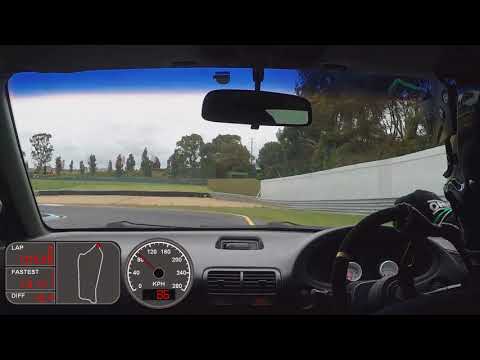

              The Cup Day Sprint was VSSC round 7, sessions were long at 20 mins with around 20 cars per group. Traffic was fairly heavy and I was mixed in with cars lapping quite a bit slower. My lap times throughout the day show I wasn't really able to get a clear run until the end of the day when half the field had gone home.
              A new PB of 1:29.35, pretty stoked about that but at the same time I didn't feel that lap was anywhere near perfect still so I'm sure there is more to gain. The LSD helped in dropping the times being able to get on the throttle a little earlier and reducing power on understeer a bit. Traction is still an issue on corner exit, the tyres are getting pretty loose now and I'm sliding around mid corner and going deep under brakes with ABS kicking in more often so new rubber would help a lot. The improvements have mainly come from changing down to 2nd for turn 2-4 and carrying more speed through turns 6-7 (around 10kph higher now). There's still a bit more to gain there if I'm game enough.
              Unfortunately I was having wifi issues with the gopro again and couldn't reach it to turn it on for the last session so didn't get any footage of my laps in the 1:29's. I've posted a video of some of my earlier laps that were around the 1:31's anyway, I was making a few mistakes as well as coming up behind other cars.

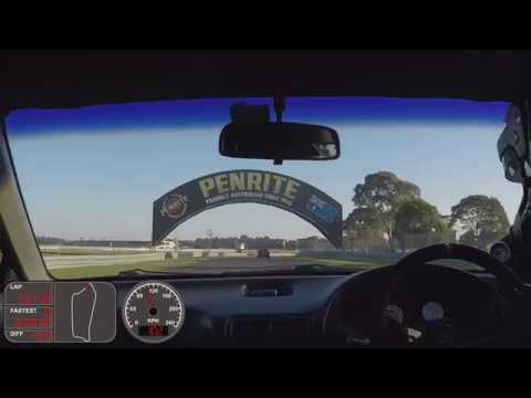

                      New wheels - 6UL's with 225/45R15 NT01's. Tyres are used, maybe a little better condition than my 205's. Managed a new PB 1:29.16 at Sandown back in June with no other changes to the car.
                      Racechrono says there's 1:27.86 optimal so I'll keep trying at that.
