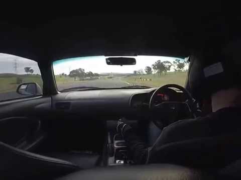

                19/05/15 - FORMULA COMPANY SMSP TRACK DAY
                Track day number 6 for the car and myself but the first time at Sydney Motorsport Park. The event was held by The formula Company with race cars having the morning session (8am-12pm) and road cars having the afternoon session (1pm-5pm). Road cars were split into beginner and advanced groups with 6x20min sessions each.
                I chose the beginner group as this was my first time at SMSP and was unsure of what to expect. In hindsight I really should've chosen the advanced group as I was held up a lot during my sessions. At least I know now for next time.
                Overall the day ran very smoothly with zero issues. The track used was the Gardner GP circuit (3.93km) which is the same circuit used during WTAC so it was cool to be able to compare to the cars that run in that event during the day (still a long way to go before I'm at their level).
                I'll just get this out of the way now before we begin with the session breakdowns.
                I LOVE SMSP!!! The track is amazing! It is fast but it's very flowing and was so much fun to drive on.
                Having only raced at Wakefield before It was a bit daunting at first but after a few laps you learn that there is just so much room.
                Session One
                I used the first session of the day to learn the track and get a feel for it and the car and eased into it lap after lap. The first couple of laps I was cautious and trying to follow other cars and learn lines.
                By the end of the session though I was lapping around the 2.00 minute mark.
                Throughout this session the car felt very neutral and was very easy to control as I went faster and faster. For this reason I opted to not adjust anything on the car for the rest of the day and to just focus on my driving lines etc.
                Session Two
                This session was more of the same from the last as I just continued to push harder and harder. It was a big jump going from Wakefield where the top speed is 170km/h down the straight to SMSP where you're going through turn 1 at the same speed.
                The car continued to feel really good and inspired a lot of confidence though and I continued to push harder and brake later.
                Times in this session dropped into the 1.56s.
                Encountered a fair bit of traffic this session as well.
                Session Three
                Pushed more and the car just went where I put it. Lots and lots of traffic this session and really only got two clean laps in. These two laps are the ones in the video. Back to back 1:54.0x. Both laps weren't the cleanest either with the fastest lap (1:54.03) having a mess up at turn 6 where I downshifted another gear for some reason and over braked then up shifted again. This dropped my speed through this turn by 12km/h and definitely stopped me from getting a 1:53.xx lap time.
                Session Four
                Decided to get an instructor in the car for this session to help me better my lines throughout the track. Main issue was turn 2 where I consistently took different lines and couldn't quite figure out how to best attack it.
                Having the instructor in the car was a great help and I learnt a few places other than turn 2 where I could better my lines. Not even pushing 100% my times were around the 1.55s so his help was working. After a few laps of me driving I asked him to do a few laps driving to see just how the car could drive with a professional behind the wheel. He obviously didn't push 100% but even still he was braking a lot later than I was and carrying much higher speeds through turns etc
                He lapped a 1.51 on his second lap in the car so I know there's plenty more left in it.
                He commented on how well the car turned in and rotated through turns and felt very flat throughout the track. He was very impressed with the car so that's a good sign on how it is set up currently smile emoticon
                Session Five
                After having the instructor in the car I was really keen to get out in this session and push harder than I had done so far in the day. Encountered a lot of traffic and only got a few solid laps in before it started to lightly rain.
                One particular lap I got held up behind a car through turn 7 and 8 easily costing me 2+ seconds. That lap was still a 1:54.66 so again I wish I had a clean lap to put down a solid time.
                After the rain started to fall a few cars left the track and there was less traffic. During this period I put down 3 back to back 1.55s but the wet track just meant I wasn't going to get maximum grip.
                Session Six
                By this stage the rain had started to fall a bit heavier. No new PBs we're going to be set with the conditions so I decided to leave early as I had work that night.
                PROS:
                -car feels great! (square set up is amazing)
                -good consistent lap times
                -a lot more time still left in the car
                -instructor session yielded lots of info/tips
                CONS:
                -weather hampered last two sessions
                -really need to fix go pro recording (don't like how dark it records)
                -so much traffic! Advanced group next time
                -tyres are near wear indicators
