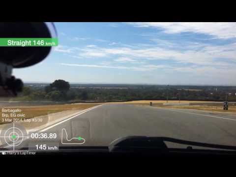

                      Video of long track:
                      Long Track

                            Don't mind me sharing a few thoughts. Definitely some good times you've done. I have no doubt you'll crack the 1 minute barrier. My goal on street tyres is to hit 58 seconds this year on the short and 55 seconds on semis. But here is abit of my analysis from the video on seconds where you can improve.
                            0:10 seconds - Your late apex point is good. I would suggest though entering it using a slightly larger radius (0.06 seconds) as your line through the "S"" will be much more linear. It looks like you have made a few adjustments to the steering wheel and really it should be more or less a straight line through that section. The S section is technical not because of its bends, but because of the hair pint before that. More straight you can travel through the S's, the more speed you can put down.
                            0:18 seconds - That big g-force corner I can see you wiped a fair amount of speed off. I believe you can probably brake a little bit later. Looking at you driving through that section and hearing your throttle response, you should be able to maintain a consistent 100km/hr+ around that corner. It sounded like you backed off the throttle abit. Especially with your weight category. My car is (1.2tonnes). Having said that I don't know how accurate Harry Lap timer is.
                            0:57 seconds - Sounded like you brake quite early. Did you back off the throttle and glided into the corner and it seemed like you took a wide and latish apex. You had alot of room to exit on the straight at 1:05 seconds. Just need to commit to your late braking and be confident to take that apex.

                              Yes I still have a few items to tidy up on my lines and braking points, I havent hit ABS yet and hence didnt pass the threshold braking point so there is more room for improvement there as I gain confidence in the braking of the car.
                              I also need to trust the cornering capabilities, as you said the car is lighter and i'm still learning that I can carry more speed in most corners than I am accustomed to, and in a low powered car corner speed is king to a good lap time.
                              Instructor (Geoff Duckworth - who races streetcar/ipra in a mirage and soon to be K20 EK) said overall not bad bar not using the full width of the track
                                Duckie is an amazing front wheel drive instructor. His my instructor too. If you ever get the opportunity you should join me some time to book the whole track out for 3 hours. I plan to do that some time in the next couple of months to have more 1on1 time and to do some data analysis. Overall your doing great!
